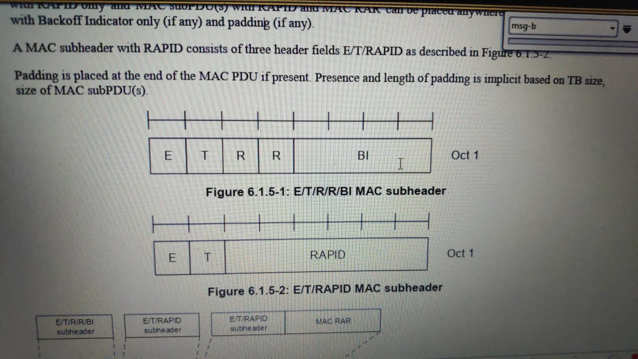

In RAR (Random Access Response), how would an NR UE know whether it has only BI, or RAPID or RAPID and Mac RAR?
Because I don’t see any bit here telling this difference:
Basically the confusion here is only between Rapid only case and Rapid+Mac RAR case.

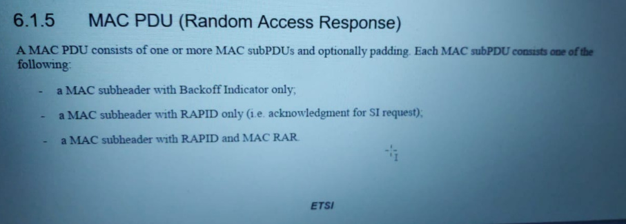

We got the TB block and we decoded those TB blocks, which we received from PDSCH in form of MAC PDU, and this MAC PDU consist one or more MAC subPDUs and optional padding & the presence and length of padding are based on the available TB size and the size of MacPDUs.
And each mac subPDU consist (BI,RAPID,RAR).

But how are you differentiating a RAPID only and RAPID +MAC PDU subheader?
As there is no explicit bit to tell you this.

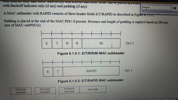

Subpdu signalling all the information BI rpaid and rar
But subpdus acknowledges SI request, where it consits of mac subheader for rapid.

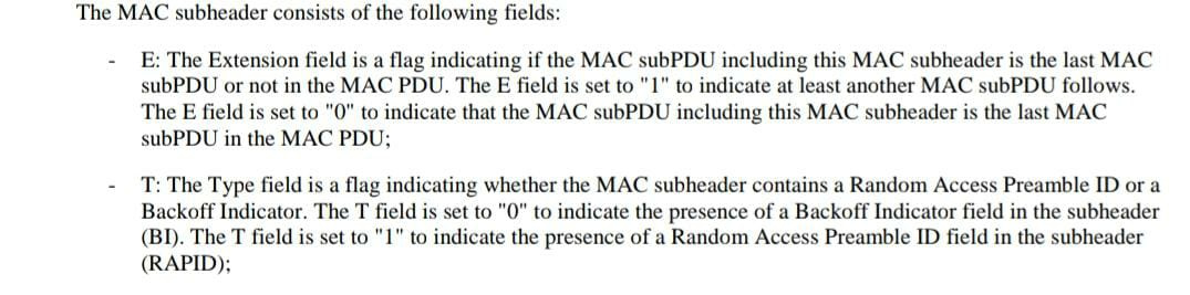

If T= 0 then macsubheader carrying BI.
If T=1 then RAPID.
This is clear.
Now lets say my case is RAPID+ MAC RAR, how does the UE know it is not the case of RAPID only?
How many bits we have for RAPID and for RAR?
1 OCtet for RAPID, 7 Octets for RAR.
So total 8 Octets.
This is a little complicated:
Like we have MAC subpdus and one subpdus contain BI one contain RAPID and one contain RAPID plus RAR.
Now in RAPID and RAR we have both subheader.
When we have T=1 meand RAPID, plus we have RAPID subheader, and we have six but random access premable identifier .
If value of E = 1 it means more subpdus in one MAC pdu.

After UE reads RAPID OCTET, what makes it not look for MAC RAR is the question here.
It can stop at RAPID or it can go ahead read MAC RAR.
What about T field?
BI and RAPID difference…but not RAPID+MAC RAR difference.
