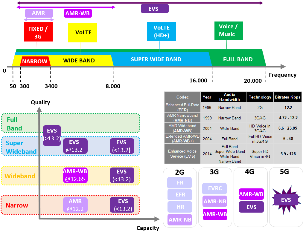

It allows to have HD VoLTE speech codec, and classified into EVS narrowband, EVS wideband, EVS superwideband, and EVS fullband. Either 5.9 or 13.2 or 16.4 kbps [Amr does 12.2 to 5.9]

Yes. Thinking of codec change from EVS to AMR is illogical as EVS is more robust compared to AMR under same radio conditions.
