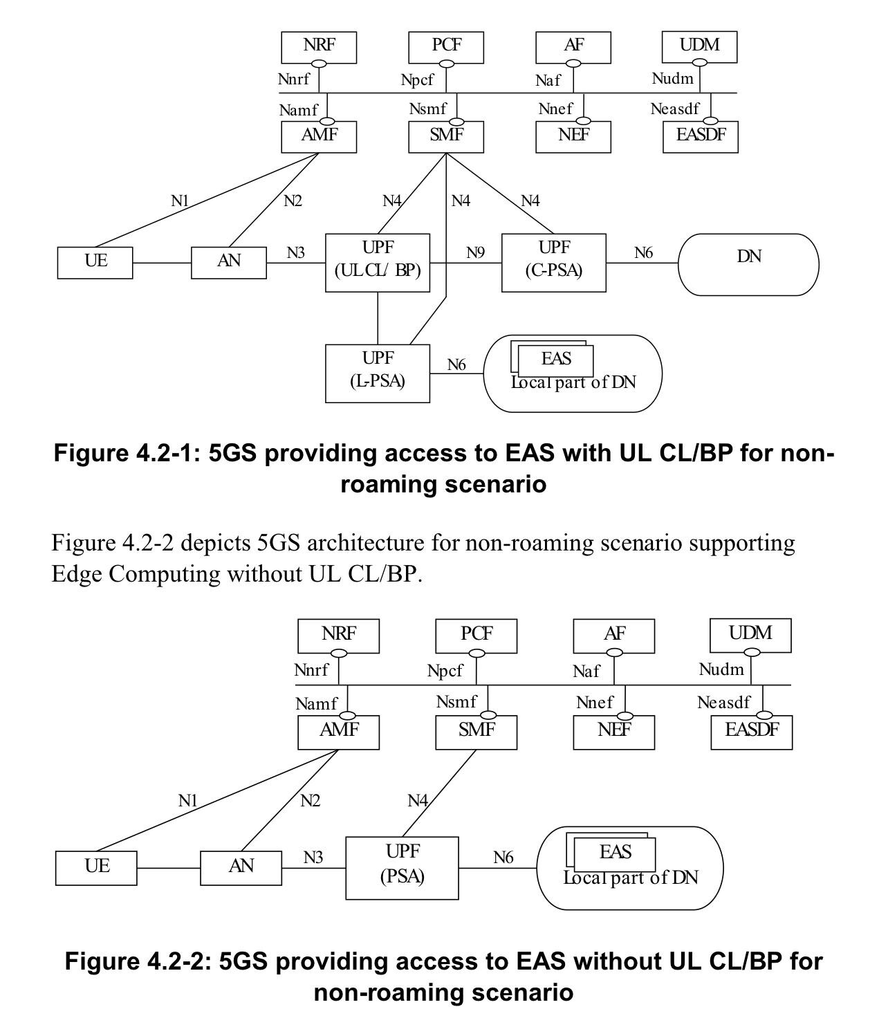

I may need to understand more details on what you want to achieve, but 3gpp define many architecture targeted for use of MEC you can use one of them for your use case.
So basically it will depends on your UPF, if is supporting UL CL or not, and if is your CU supporting RAN slicing or not, as you may have to create different slice for you packet routed to your main UPF or anchor UPF and MEC or low latency UPF.
Refer to following figure:
