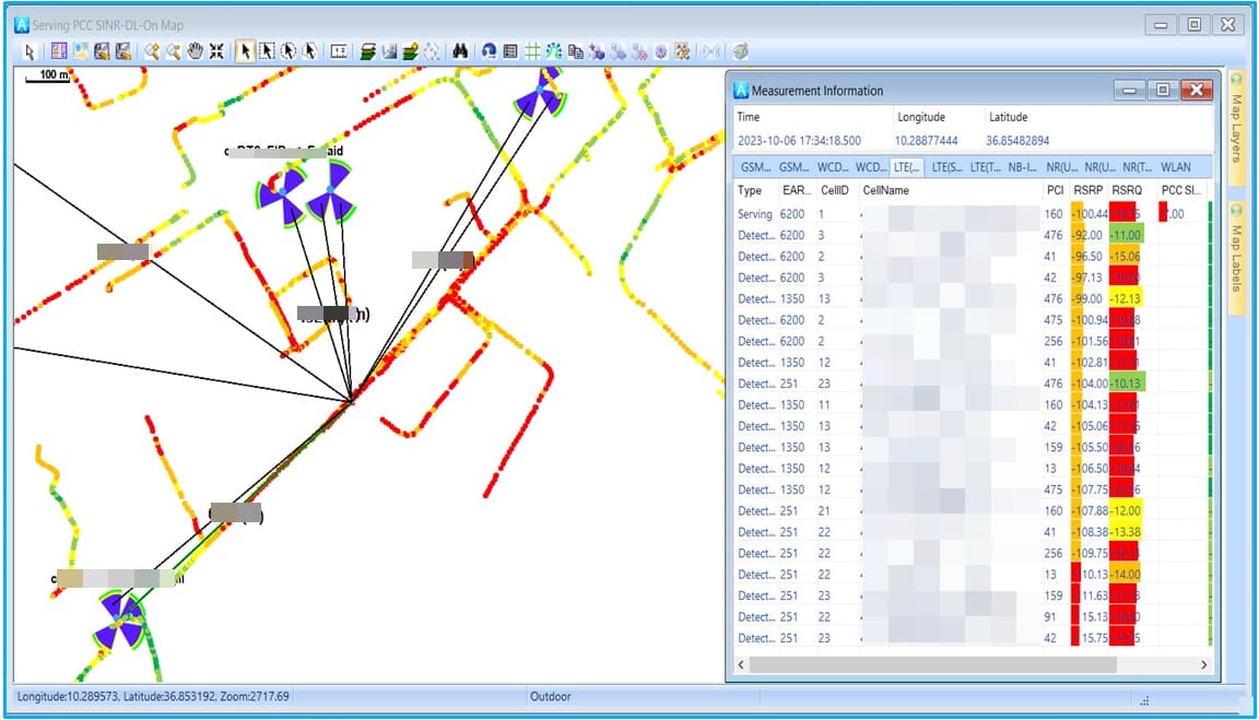

You should run a Drive Test.
To ehance SINR , you have to eliminate the interference , check the overshooting cells from Drive test and solve it

Yes, UEs serving on far eNodeB (overshooting cell) are a disaster for surrounding cells due to Uplink Interference.
So I think first dominance have to be fixed first and avoid having Ues served by enodeB at a distance larger than 1-2 kms in cities.

Uplink of an overshooting cell will kill lot of surrounding cells uplink.
Check TA counters and avoid serving cells from more than 2 km maximum.
