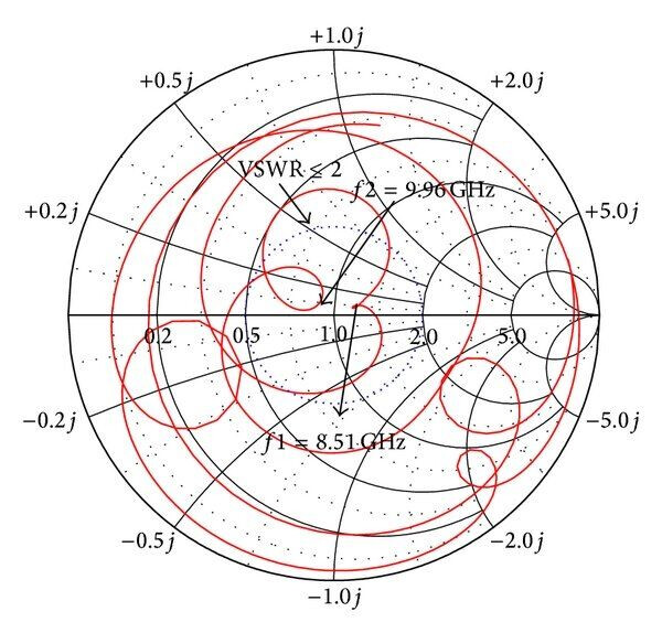

Th Smith Chart below shows how the antenna’s impedance traces move across frequency, revealing both matching quality and reactive behavior for its dual-band operation. The red loops illustrate how each band shifts across the chart, highlighting where VSWR ≤ 2 is achieved and where detuning or strong reactance appears.
