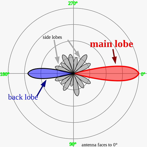

Side lobes means unwanted radiation in undesired directions, and it is generally desirable to minimize the sidelobe level (SLL), which is measured in decibels relative to the peak of the main beam.
If they are too high it can cause interference in an adjacent whilst also being susceptible to interference from adjacent links.
No! Side lobes cannot be completely removed.
They can be reduced by really good and expensive RF filters but not possible to remove them. Mathematics doesn’t allow that.
Remember Fourier transforms!

Side lobes in smart antenna are at least 15 dB under main lobe!

Main lobe can be steered in any direction with 105 degrees H and 30 degrees V.
Side lobes generate little interference due to 15 dB difference from main beam.

That amount of power is not much and is an output, side effect, of beamforming.
You confuse power with attenuation. 15 dB is attenuation of side lobe from main lobe!
