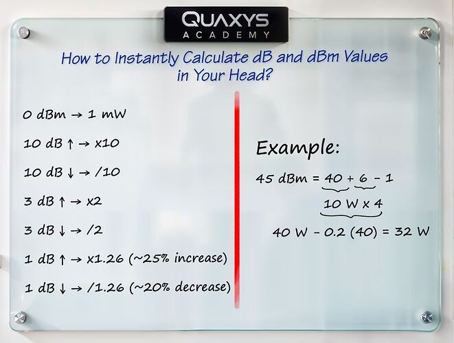

Key dB Mental Math Rules:
- 0 dBm = 1 mW (your reference point)
- +10 dB → Multiply by 10 (10 dBm = 10 mW, 20 dBm = 100 mW, etc.)
- +3 dB → Multiply by ~2 (3 dBm ≈ 2 mW, 6 dBm ≈ 4 mW)
- +1 dB → Multiply by 1.26 (~25% increase)
- -10 dB → Divide by 10
- -3 dB → Divide by ~2
- -1 dB → Divide by 1.26 (~20% decrease)
Example: Calculating 45 dBm Using Mental Math
Let’s break down 45 dBm using simple dB steps:
- Start with 40 dBm
40 dBm = 10 W (Since 10 dBm = 10 mW, 20 dBm = 100 mW, 30 dBm = 1 W, and 40 dBm = 10 W)
- Add 6 dB (≈ ×4 multiplier)
40 dBm → 43 dBm (+3 dB = ×2, so 10 W × 2 = 20 W)
43 dBm → 46 dBm (+3 dB = ×2, so 20 W × 2 = 40 W)
But we need 45 dBm, so we take a step back…
- Subtract 1 dB (~ ÷1.26 or ~ -20%)
46 dBm = 40 W
45 dBm = 40 W - 0.2 (40)W ≈ 32 W
