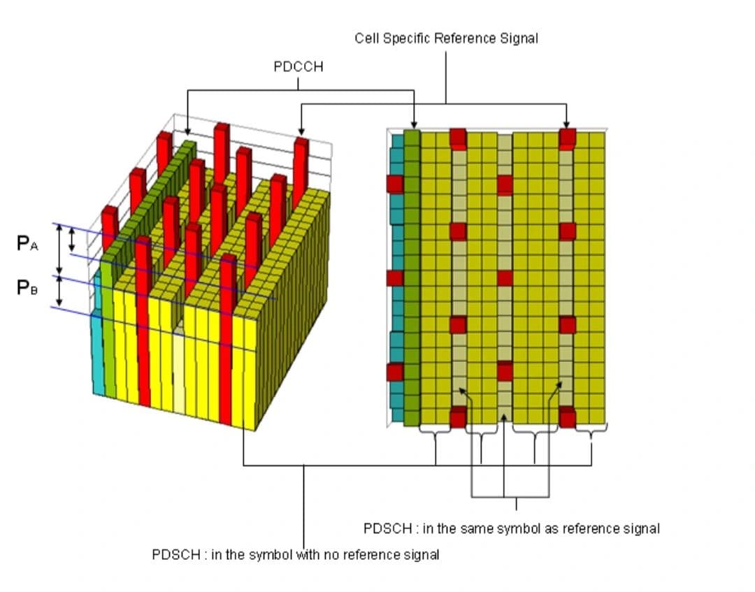

Understanding PA and PB
  • PA (Power Allocation): Controls the power offset between reference signals and PDSCH (Physical Downlink Shared Channel) symbols without reference signals. A negative PA value means less power is allocated to PDSCH symbols.
  • PB (Power Boosting): Determines the power offset between PDSCH symbols with and without reference signals. A higher PB value means more power is allocated to PDSCH symbols without reference signals.

Some optimal PA and PB configurations include:
  • (PA, PB) = (0, 0)
  • (PA, PB) = (-3, 1)
  • (PA, PB) = (-4.77, 2)
  • (PA, PB) = (-6, 3)
Keep in mind that the ideal settings may vary depending on your specific network configuration and requirements.
