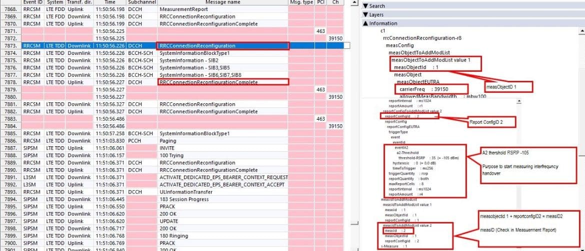

1.Current Serving Frequency: 39150
Measurement Object ID (measObjectId): 1
Report Configuration ID (reportConfigId): 2
Measurement ID (measId) = measObjectId + reportConfigId = 2
(This is what you check in the Measurement Report)
  1. (measId: 2) RSRP (serving cell): -105 dBm. This meets the Event A2 trigger condition.
    Once this condition is met, the UE will start measuring neighbouring cells on other frequencies.
  2. The node sends an RRCConnectionReconfiguration message that includes:
    Inter-frequency measurement configuration.
