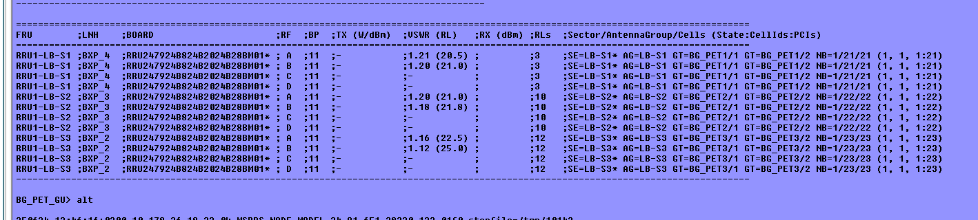

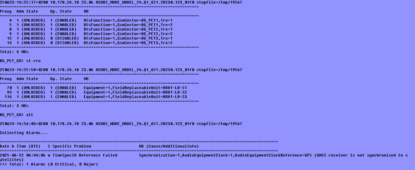

I suspect something is locked, failed or misconfigured from RBS side. Check alarms/states on the node st trx, st rru, alt.
There is something wrong with trx 1&2 in sector PET3. Is it STG-637? How problem was start?
print sdir command
looks all fine
yes its 637, i restarted bbu, and now is fine. we have too many this alarms i n network, dont know root cause

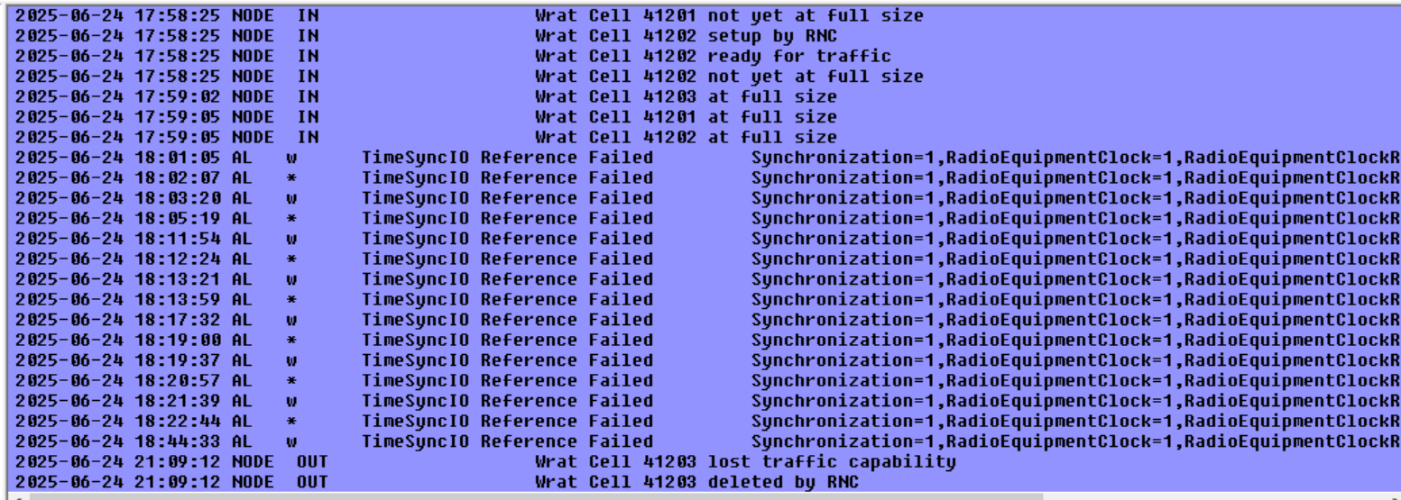

Check logs lgaevgmr, what comes before this issue.

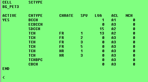

i tried this fastrec, but again i have this alarm, and now is one trx down, CELL LOGICAL CHANNEL AVAILABILITY SUPERVISION CELL SCTYPE CHTYPE CHRATE SPV BG_PET3 TCH FR 1 END. Alarm showed at 19.54h and i dont have anything before that in log .

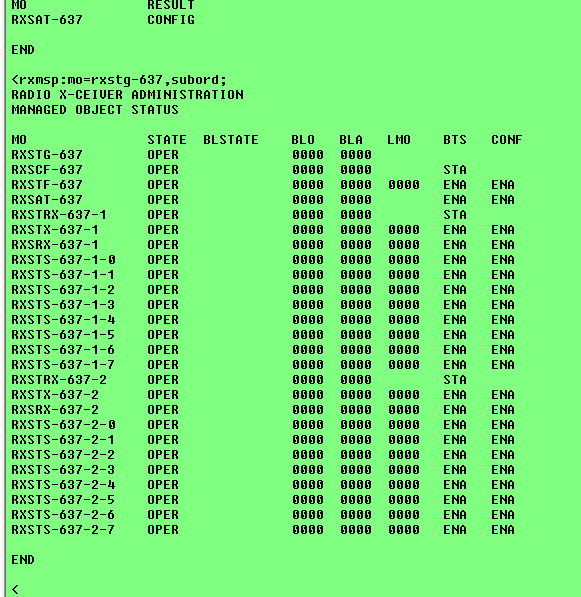

We are getting mixed signals here in rxmsp print everything is working in st trx print trx was disabled, was the print done right after rru restart, cuz it takes some time for cells to get back. Also make RLSLP print. Mybe just someone changed alarm thresholds or config like setting off VAMOS.
rxmsp was printed after bbu reset, and st rtx after alarm appeared

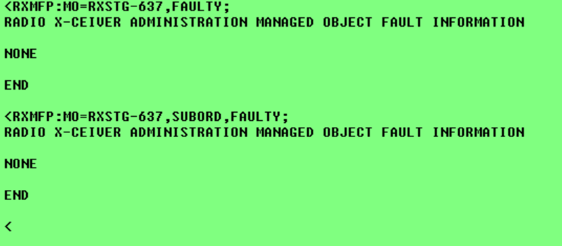

Can you share this output for problematic STG when alarm is active, pls:
RXMFP:MO=RXSTG-637,SUBORD,FAULTY;
or if above fail
RXMFP:MO=RXSTG-637,FAULTY;
