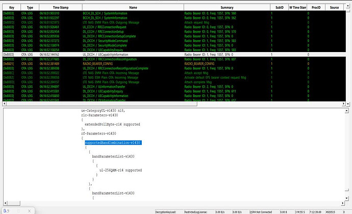

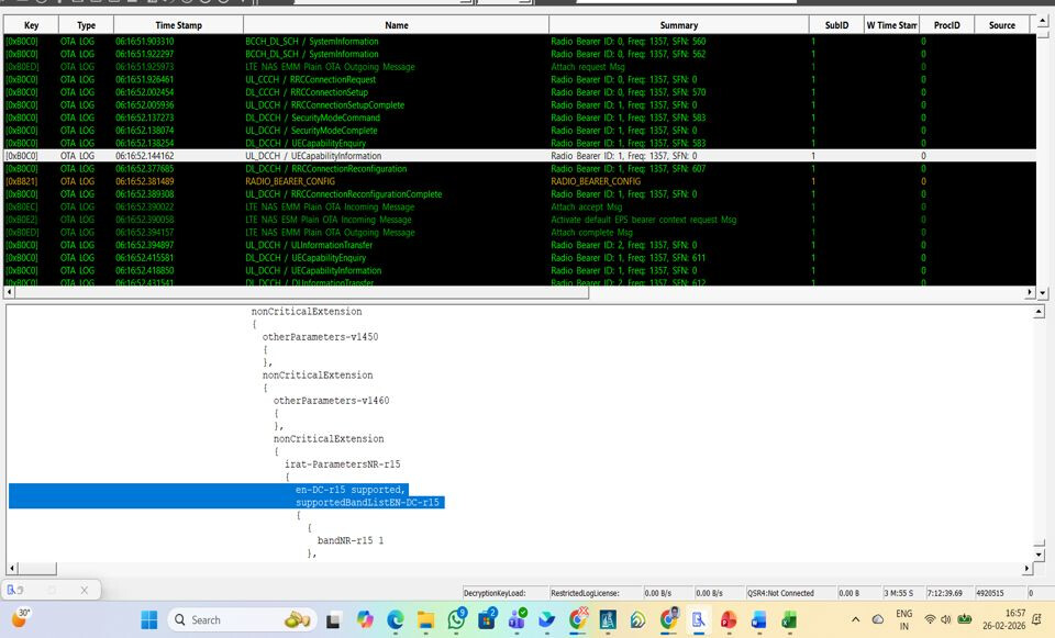

:pushpin: From UE Capability Information, we can verify:
en-DC-r15 supported
supportedBandListEN-DC-r15
NR band combinations
LTE Category & RF parameters
This confirms whether the device is NR capable and supports EN-DC (NSA 5G).

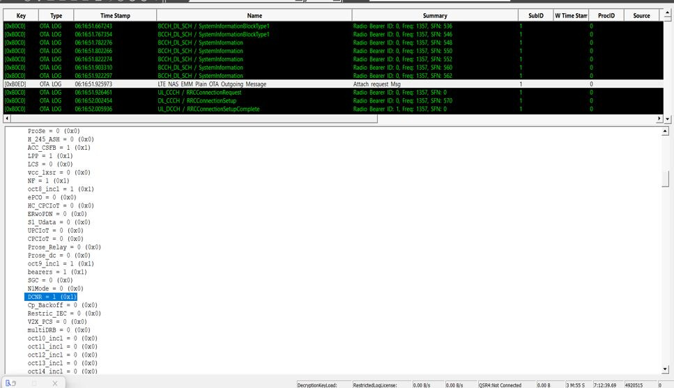

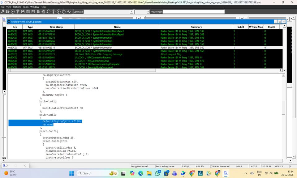

:pushpin: From SIB / RRC messages, we can check:
Paging cycle configuration
Default paging parameters
DRX related configuration
System Information Blocks (SIB1/SIB2)
