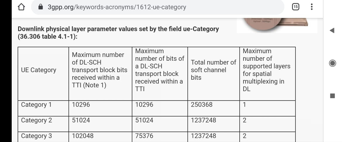

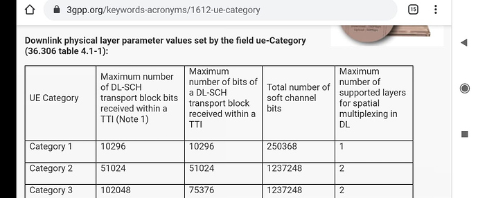

Look at the last column in the table, it has mentioned that max number of supported layers for spatial multiplexing.
Downlink physical layer parameter values set by the field ue-Category (36.306 table 4.1-1)
Thanks @gkreddy, but only layers mentioned.
Not mentioned whether it’s tm4 closed loop…
