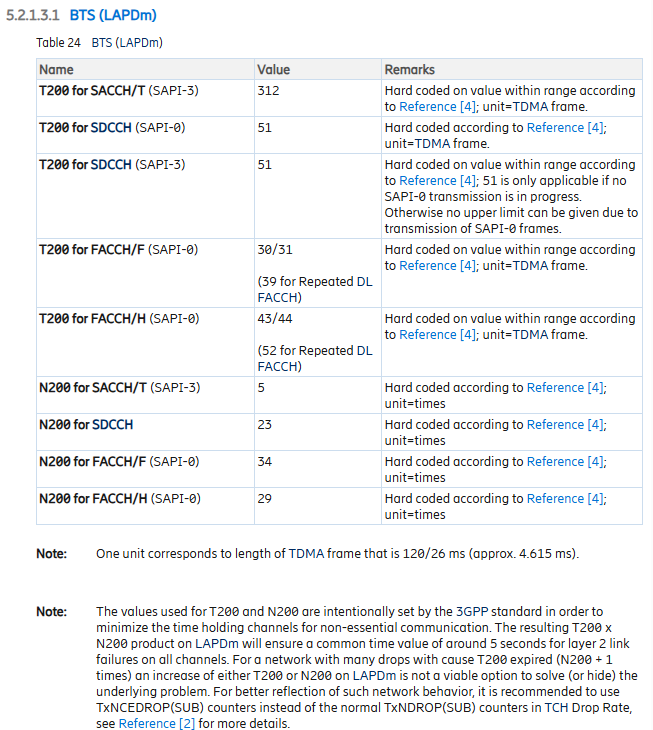

Hi. @vlr9999 Thanks for your response, but I think SIGDEL/LDEL paramters control the T200/N200 for LAPD, which is this protocol for the Abis link between the BTS and BSC.
As there is another protocol called LAPDm, which is for the Um link between the UE and BTS.
Meanwhile, in Huawei, they provide T200 / N200 for LAPDm that controls SDCCH / FACCH acknowledge time in the UM link as well as T200 / N200 for LAPD. But E// is out of coverage in this topic, I think.
Hi, @Marwan97, values for LAPDm are hardcoded also
@vlr9999 what does hardcoded mean? does it mean these parameters can’t be change
Hi, @Marwan97, yes, there are some predefined values and we can not change.
