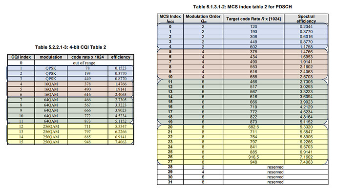

3GPP tables for CQI to code-rate / efficiency and MCS to code rate efficiency are shown in the table.
UE manufacturers have a propriety table for SINR to CQI reporting. This CQI gives the range of efficiency and the code rate UE can support based on the current feedback.
gNB OEMs also have a proprietry mechanism to consider configured BLER target or how often change it, based on these inputs one of the MCS can be selected in the range of reported CQI.
eg: CQI 12 reported by UE then MCS 20 to 27 can be selected based on the link adaptation algorithm set by the gNB OEMs
