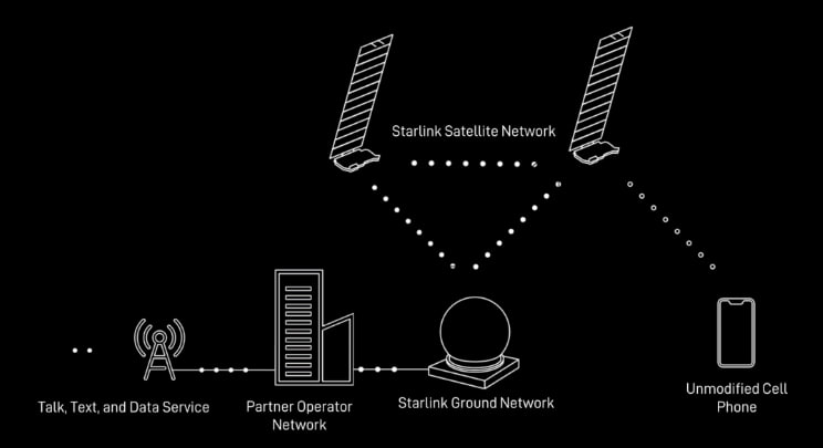

  3. The next generation satellites from Starlink will have point to point connectivity between them providing X2 connectivity and data forwarding.
  4. Each satellite will have a huge footprint (50 km or more) and provide coverage in no cellular coverage areas only, so not much traffic and device mobility. The handovers will be mostly due to Satellite mobility and that will be known in advance.

Overly simplifying, there are 2 deployments scenarios
  • RU/DU functions at satellite
  • RU/DU functions at ground station

How NTN(starlink’s direct to cell) will work with LTE? They have stated messaging in the first phase and calling in later that to with unmodified LTE device?
Will there be a 3GPP release upgrade? DL is bit clear, how UL will work? as LTE itself is restricted
