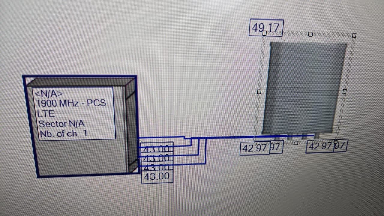

How much power (EIRP) will be radiated from the antenna when RRU (4 Port) feeds 20W power from each port to antenna?
Hello Dears.
Here’s an example from iBwave:
You mean 49.17 dbm will be radiated?
Based on the antenna gain.
It’s radio power + antenna gain - losses ( cables, connectors…)
