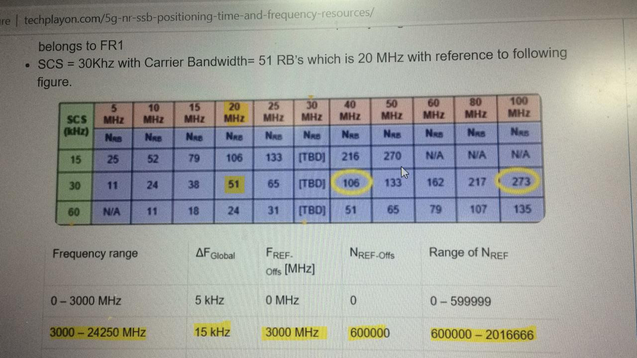

Most of time it’s 273 prb use with 100 mhz for fr1.
