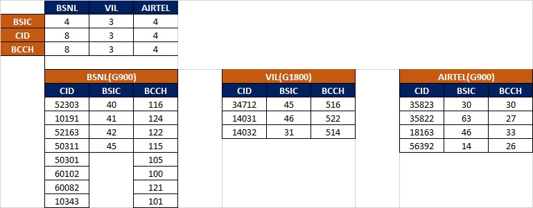

So, we have this data, collected from Drive Test.
Is any operator planning data incorrect? Or all is good?
All looks good.
