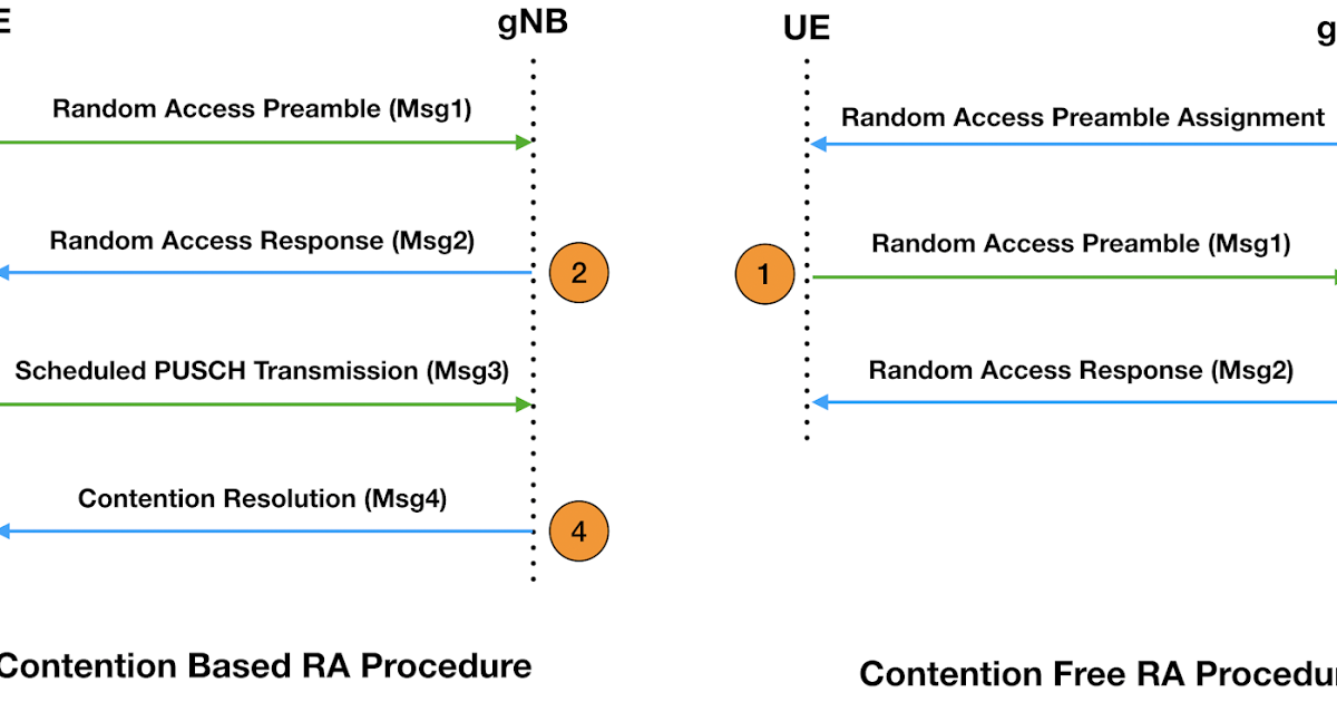

RACH is the first uplink message which is sent by the UE to the Network for uplink synchronization via the PRACH channel and RACH is handled by the MAC Layer.
In LTE and NR there is a basic difference in the RACH procedure LTE there was no concept of the beam but, In NR SSB (Synchronization Signal / Physical Broadcast Channel (SS/PBCH) Blocks) is associated with the different beams.

:two: Random Access Procedure :game_die::artificial_satellite:
Once the UE has obtained the necessary downlink information, it initiates the uplink synchronization process by performing a Random Access Procedure (RAP). The UE transmits a Random Access Preamble (RAP) :mega: on the Physical Random Access Channel (PRACH) to notify the gNB of its intention to establish an uplink connection.
:three: Random Access Response :satellite::loud_sound:
Upon receiving the RAP, the gNB sends a Random Access Response (RAR) :loudspeaker: back to the UE on the Physical Downlink Shared Channel (PDSCH). The RAR contains crucial timing and frequency corrections :clock2::ocean:, as well as an initial uplink grant, allowing the UE to adjust its transmission and align with the gNB’s timing and frequency.
:four: Uplink Transmission :iphone::rocket:
After applying the corrections and receiving the uplink grant, the UE begins its uplink transmission on the Physical Uplink Shared Channel (PUSCH) :outbox_tray:. This transmission is now synchronized with the gNB’s timing and frequency, ensuring accurate and efficient data transfer.

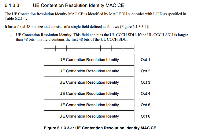

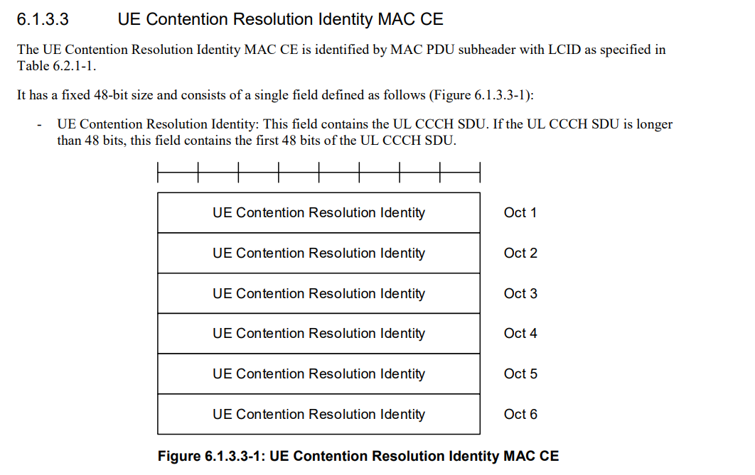

Are you sure? UE is sending 48bits of random value in RRCSetupRequest message.
Will you please share any log print here?
I have always observed 39bits.
and for UE contention resolution- UE check if CCCH SDU(RRCSetupRequest) of 6 Bytes should be match with MAC supPDU(msg4) of UE Contention resolution identity of 6 Bytes.
from 38.321
