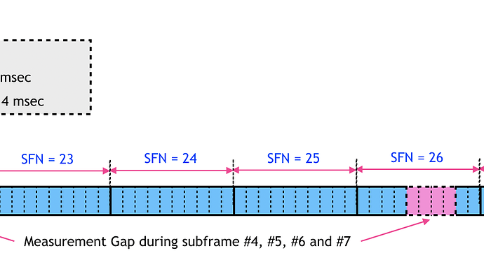

Typical LTE gap length is 6 ms which accommodates 5 ms measurement time (PSS and SSS are transmitted once every 5 ms) and RF re-tuning time of 0.5 ms before and after the measurement gap. The measurement gap repeats with a periodicity of either 40 ms or 80 ms.
The eNB provides measurement gaps in the scheduling of the UE where no downlink or uplink scheduling occurs. Ultimately the network makes the decision,

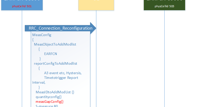

UE will get the Measurement GAP configuration from RRC_Connection_Reconfiguration message while attaching to network and the Information Element(IE) is MeasGapConfig.
The MeasGapConfig consists of gap pattern type (gp0 or gp1) The gap patterns are to identify the periodicity and gapOffset
Each Measurement gap starts at an SFN and subframe meeting the following condition:
SFN mod T = FLOOR (gapOffset/10);
subframe = gapOffset mod 10;
with T = MGRP/10
where MGRP is 40 for gp0 and 80 for gp1
