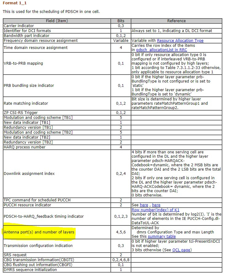

In NR, how does UE get to know about how many layers to use in DL using DCI?
More details here: 5G | ShareTechnote

No TM modes defined for NR …so no concept of switching here.
Transmission scheme 1 there.
Yes, correct.
