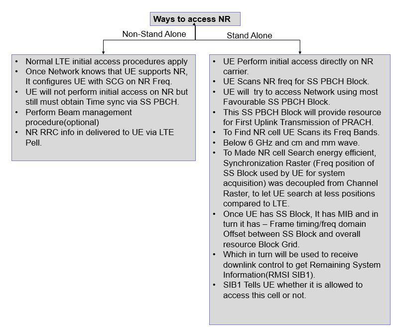

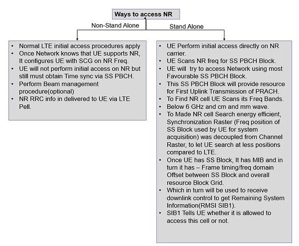

Hello experts.
I tried to compile the basic of NR access by ue in both SA and NSA.
Why can’t a UE in Standalone (SA) mode access the high band directly?
