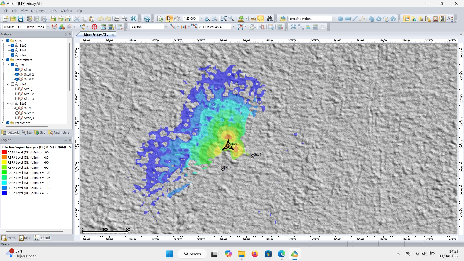

Hi expert, I’m confused about how to predict coverage from one site without interference from other sites? Any suggestions? I have tried by turning off the site and transmitter but still other sites are considered for the range prediction. Any suggestions other than to include them one by one? thanks.

If all other sites and transmitters are deactivated then the one which is under investigation then Coverage predicted should be of the one which is on. Alternate method draw a filtering zone and select the site which needs to be on and calculate.
