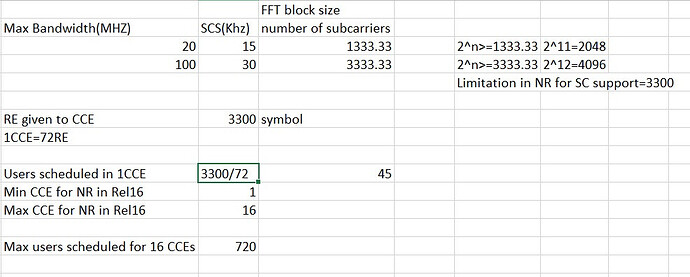

How many users can be scheduled in NR can be calculated based on max CCE configuration.
Do we have any parameter like max UE scheduled per slot for NR?
Like LTE we have maxuepertti.
I think max 720 users can be scheduled for NR Rel16.
For max BW 100 MHz and SCS 30 kHz.
