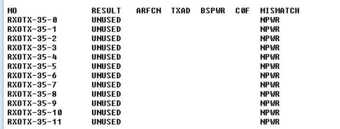

Hello Ericsson Experts.
How can I resolve the issue of TX being unused due to an NPWR mismatch?
Check power value i.e MAXPWR.
Did you try checking and rerunning the script for TX/RX creation?
Ok, i will try.
If they are not being used, it’s necessary to delete them to resolve these alarms.
Set the correct values for MAXPWR and MAXTRX on MCTR, and then compare them with the RLCPC settings on the cell to ensure alignment.
Thanks. Issue resolved!
