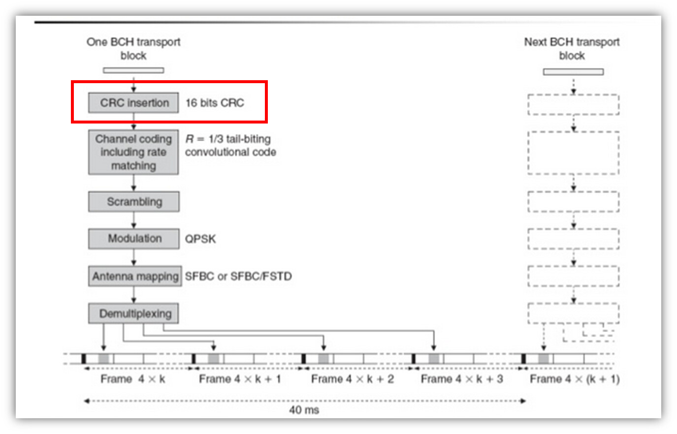

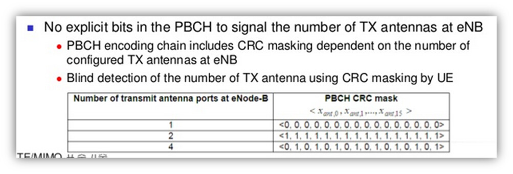

MIB (Master Information Block) that CRC_Insertion is an initial phase for BCH_TB block coding, these are 16_bit each bit_pattern refer to how many Antenna_port as shown in picture. So at receiver side and during PBCH_TB decoding phase , it can CRC pattern that embedded from sender side based on Antenna_port number, so UE can know how many Antenna supported at eNodeb side.
