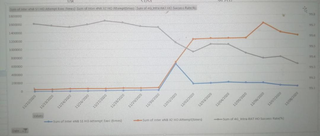

HOSR degraded after enable ANR over 100 new sites, S1 & X2 attempts increased after active ANR.
Only cells in the same eNB was defined to each other (manually).
Checked many sites, found X2 fault alarm, it happened frequently.
Any comments?

Bit weird for me in your graph we have HO_SR > 0% with no attempts on S1 before the feature activation.
