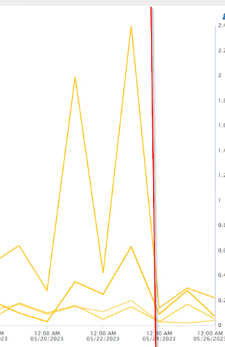

Pucch format 3 dtx rate was %5 now it is 10% after CA activation so it is difficult to find the problematic signalling.
and I tried to increase PUCCH power, nothing changed.
I also tuned the Ul data split thresholds and enabled dft-s-ofdm. No impact at all.
Last step is to decrease 5G CA secondary carrier A1 addition threshold from -110 to -105. Lets see I will share the results here.
I solved the issue. I optimized the uldata split thresholds and tuned the Open loop control parameters like nominalpucch, deltaf1/f3 , I would say using different thresholds for TDD and FDD are recommended.
The parameters have been tweaked are given below:
rlresumeSinrthreshold
rlosinrthreshold
p0nominalPUCCH
P0nominalPUCCHF1F3
case closed.
