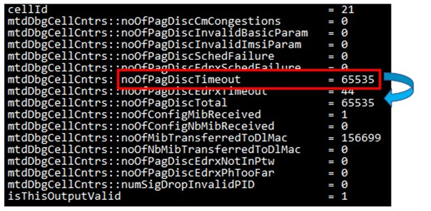

Hi All ,
I have a question on High Paging Discard failure on LTE RAN Side.
Vendor is Ericsson.
Any Ericsson expert know about the debug MTD Counter trace analysis?
Mentioned below for your reference.
My network most of failure are pagged under “noOfPagDiscTimeout”.
Does anyone have idea why this counter is pegged and what could we do to mitigate it?
Any other suggestion also welcome.

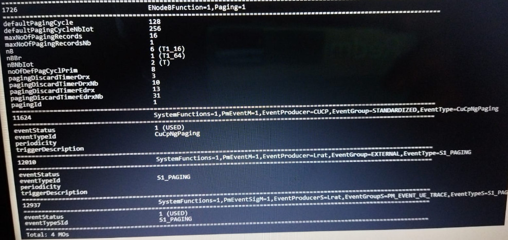

get paging=1
nB = 1/16 … to low I think.

But network baseline is 1/16.
nB=T Used to calculate the number and position of Paging Occasions (PO) and Paging Frames (PF).
The numerical value of nB depends on the value of the defaultPagingCycle (T) and can be set to one of the following values:
4T, 2T, T, T/2, T/4, T/8, T/16, T/32.
When nB is set to T, 2T or 4T, it determines the number of POs per PF, and the PO position in PF.
When nB is set to a value smaller than T, it affects the System Frame Number of the PF, the position of PO in the PF, and also distribution of UE into groups with the same PF.
When nB is set to smaller value, amount of groups is smaller, but amount of UEs inside each groups is larger. When nB is set to a larger value, amount of groups is larger but amount of UEs inside each groups is smaller.
If categoryMAccess is enabled and nBBr is set to the default value (NOT_PRESENT) then further restrictions apply. If highestSupportedCeLevelBr = 0 then nB should be selected from the following available options (T, T/2, T/4, T/8, T/16, T/32) due to the half duplex nature of Cat-M devices. If highestSupportedCeLevelBr = 1 then nB should be selected from the following available options (T/8, T/16, T/32) due to repetitions.

This problem is related with nB setting mismatch with baseline setting 2(t).
Paging discard count turn to zero.
After i changed nB from to T.
