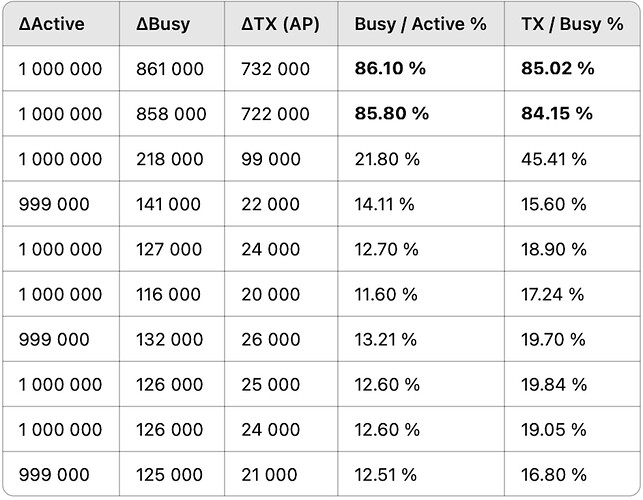

The attached screenshot is a 10-second capture from an OpenWiFi AP (Channel 149 @ 5825 MHz). Each row is a 1-second delta in µs:
What the two percentages really say:
Busy / Active Time:
  • What it measures? → "How busy is the channel overall?”
  • Why it matters? → “Includes AP, clients, and interference”
TX / Busy Time:
  • What it measures? → "How much of that busy time is my AP’s?”
  • Why it matters? → “Shows whether congestion is external or self-inflicted”
Example #1 — First two seconds
Busy / Active ≈ 86 %
TX / Busy ≈ 85 %
The channel looks slammed, but we are using almost all of that airtime.
No neighbouring AP interference—just a hungry transmitter doing its job.
Example #2 — Third second
Busy ÷ Active = 22 % but TX ÷ Busy = 45 %
A quieter moment overall, yet nearly half of the airtime still comes from our AP.
