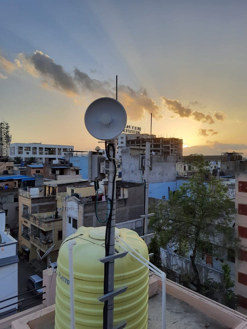

Help to identify antennae
Which are these antennae?
Used for what?
I think this are for ISP.
Usually for PTP or PTMP, it can be used for ISP for providing internet or connecting company branch together.

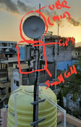

This is i think UBR antenna used for MW connectivity.
UBR MW link for small cell.
This small cell doesn’t have fiber connectivity.
Jio is have a lot of sites in Mumbai with this connectivity due to fiber is not feasible issue.
Yes, that’s right.
Yes, correct.
Small cell mentioned is then a radio antenna with remote radio inside it?
I didn’t find RRH then.
Yes it’s a micro cell with combined baseband and radio unit.
Inbuilt. Observe RF panel antenna… back of it… you can find heat sink!

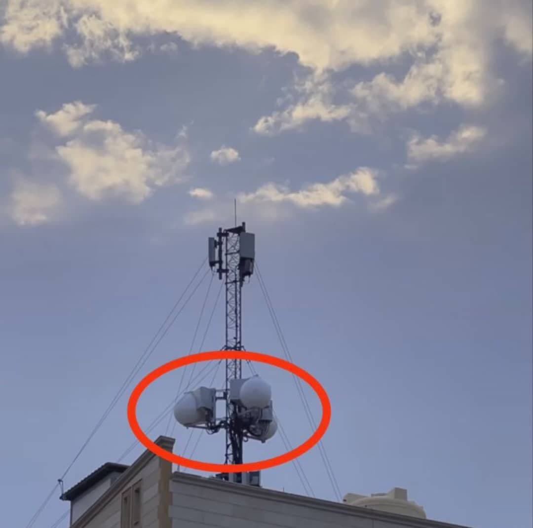

Hi All.
What are those devices in red circle?
This site in KSA.
Microwave antennas maybe.
For backhaul connectivity from BTS to Core network.
But somehow it looks way too spherical and bulged-out, than the regular Microwave antenna…
It looks like that supercell antenna: [PDF] SuperCell: A Wide-Area Coverage Solution Using High-Gain, High-Order Sectorized Antennas on Tall Towers | Semantic Scholar
