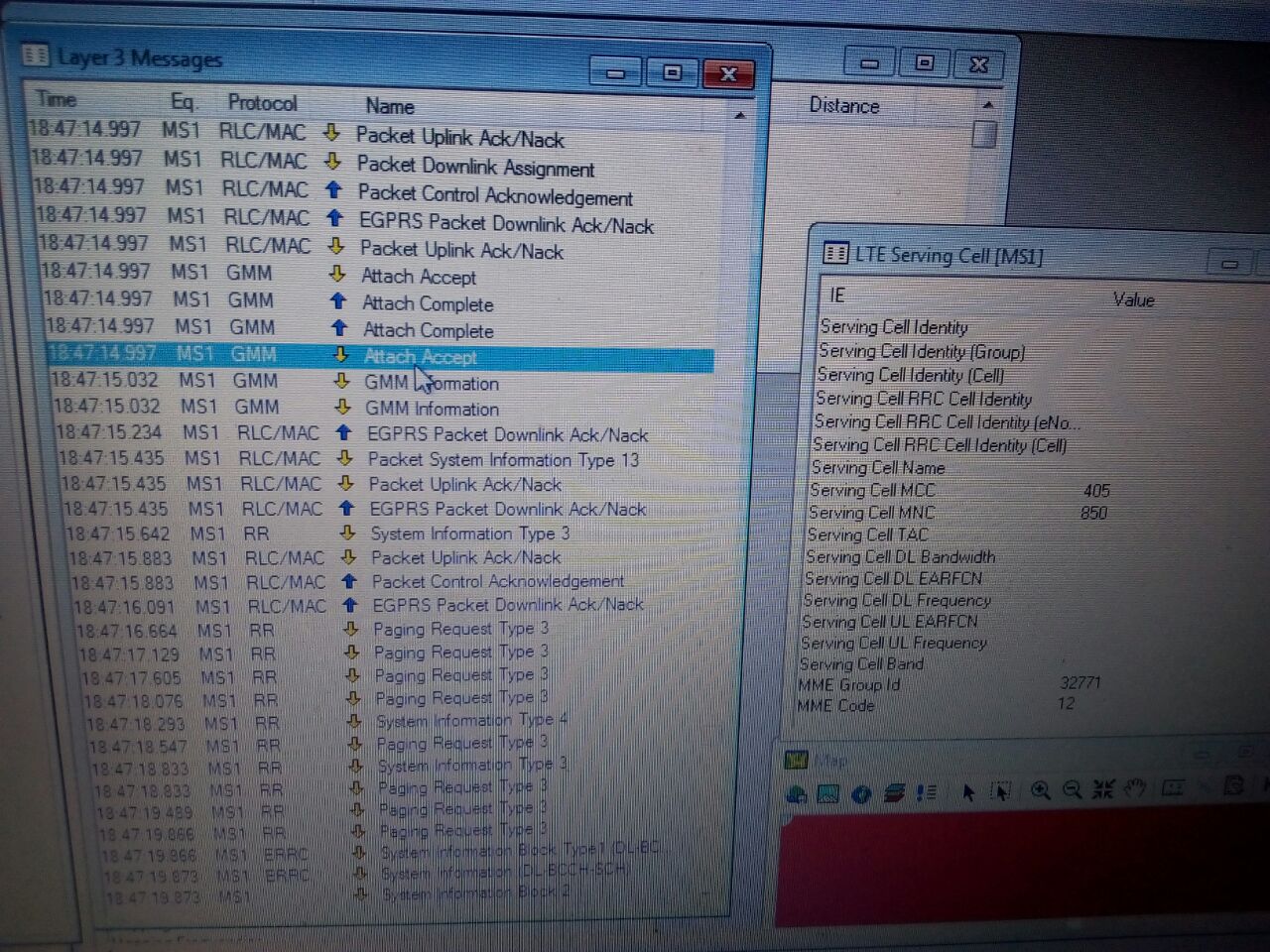

Hi…could any one guide…csfb…reselection happening smoothly from 4g-2g and vice-versa…but while attempting to manually select from 2g to LTE network not happening…need to do forced switch off on of the hs
This is the message flow

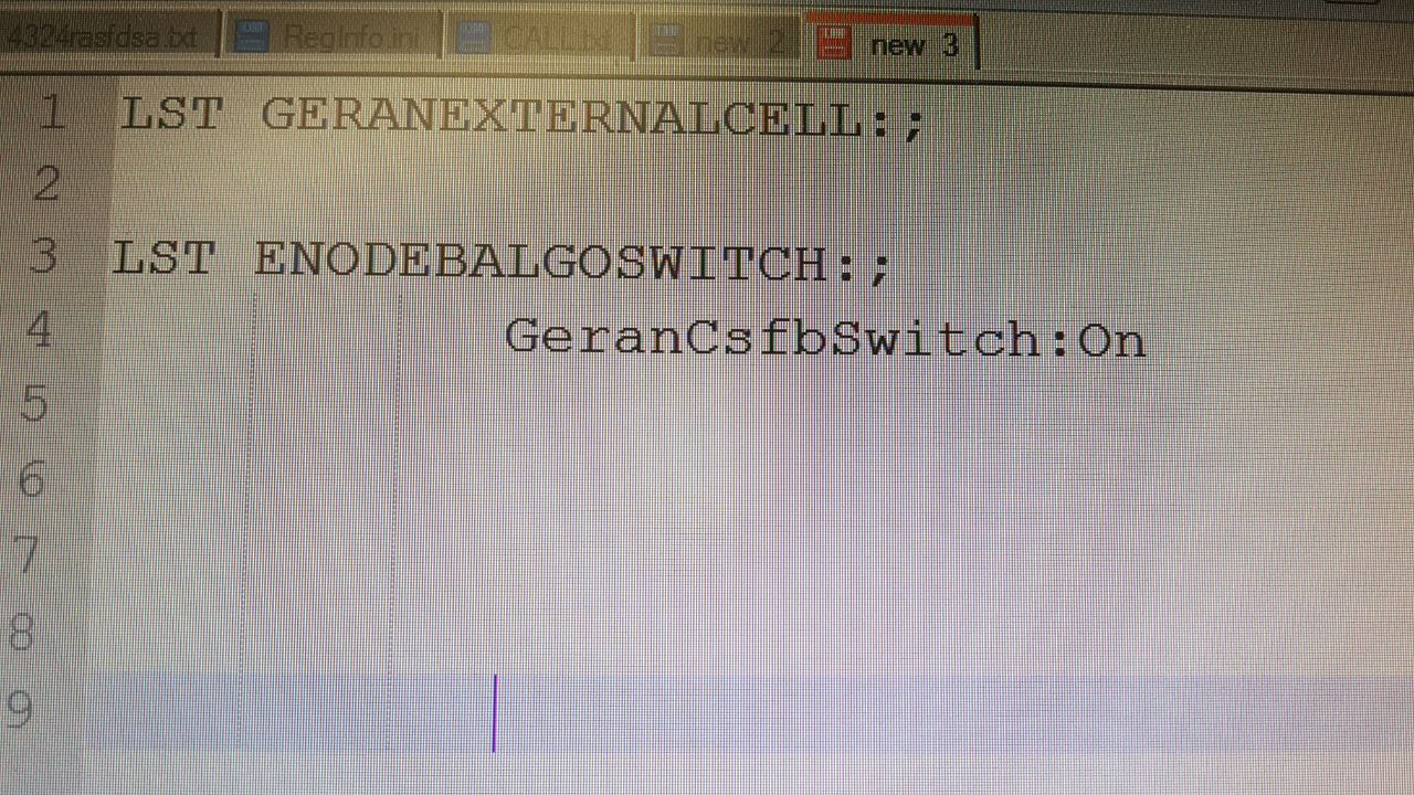

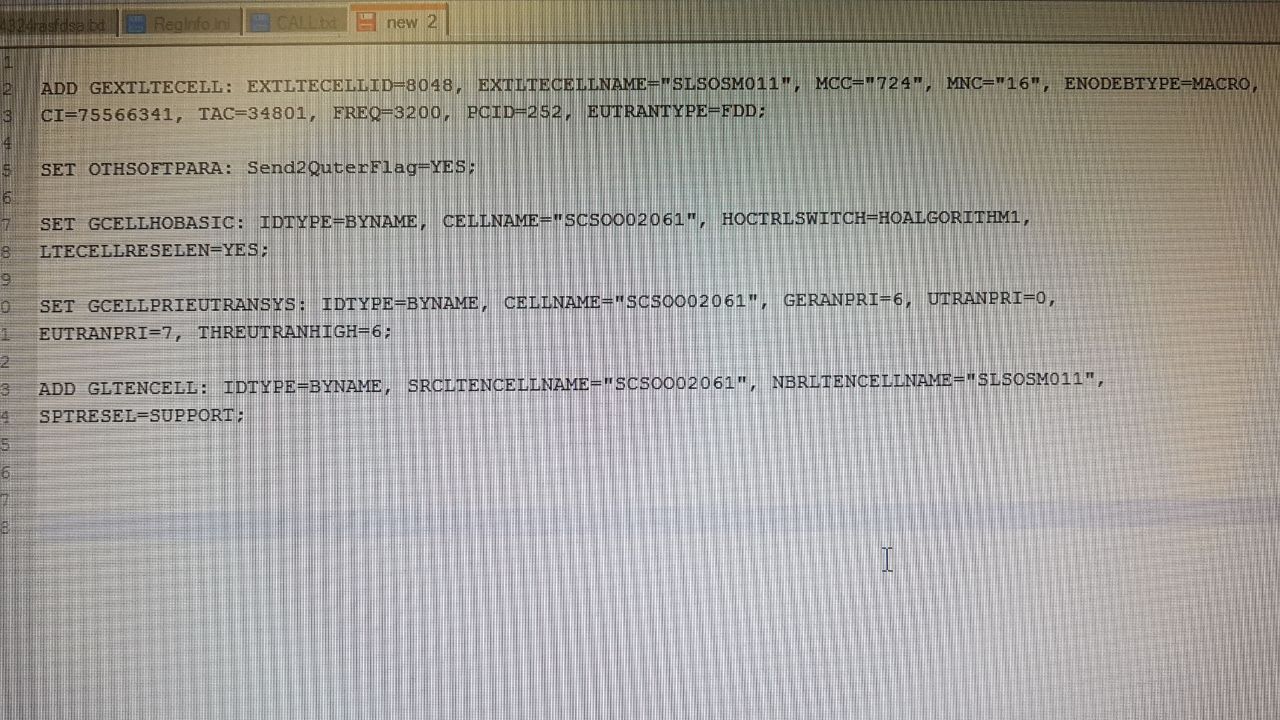

Check this one in our BSC
Use this one to create in our BSC side: MACRO CSFB.zip (8.9 KB)
…also check the switches in LTE site
