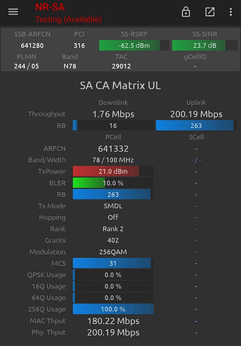

Question about 5G: has anyone seen up to now UL MIMO in 5G?
I understand that there is in 5G SA UL MIMO 2x2 for very few UEs, but not in 5G NSA.
I’ve seen only in test devices so far, either prototype or from OEMs but non commercial.

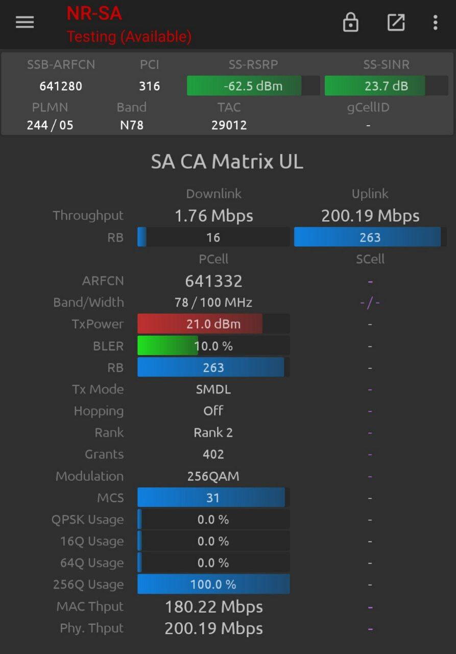

Here is UL MIMO with Snapdragon Insider Phone in Elisa Finland 5G SA network.

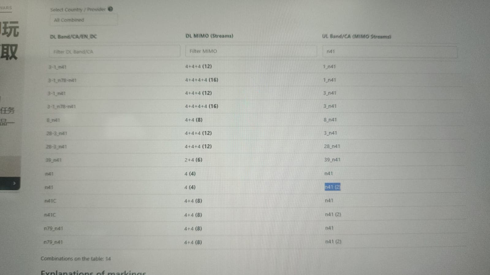

There is some commercial UE’s support UL MIMO like Mi 11 Ultra: Xiaomi Mi 11 Ultra (Global) (M2102K1G) | 4G/5G Bands & Combos

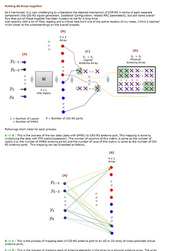

Correlation factor means the correlation between phases according to each UE location.
For example for 32 csi-rs ports for UE1 is needed those phases a1, a2, a3 … a32 and for UE2 is needed those phases b1, b2, b3 … b32.
Correlation factor is functions between those phases of UE1 and UE2.
If correlation is low UE can be paired, if it’s is high cannot be paired.
More about correlation here:

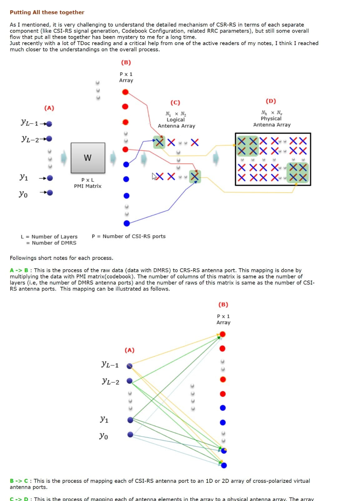

If you understand this picture you understand MU-MIMO:
This is from this link: Sharetechnote - 5G_CSI_RS_Codebook

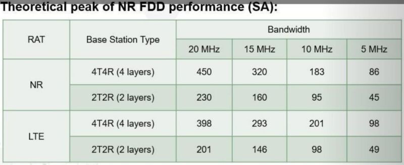

There was a question of how is the throughput between NR and LTE for same bandwidth.
This picture provides the answer:
Theoretical peak of NR FDD performance (SA)
In Nokia, it is 0.33.

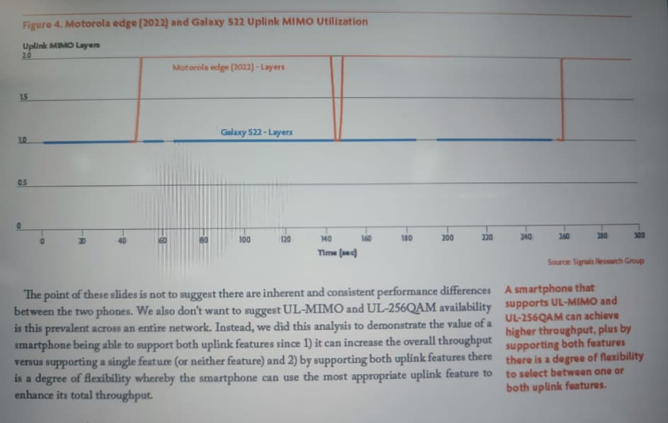

One test report of SRS show that Motorola Edge 2022 support UL MIMO 2 layers!
Yes indeed but which model is it?
I doubt it is from 2022. I do not understand what 2022 means.
Let me check on cacombos site, maybe is a prototype…
Sony Xperia 1 IV (XQ-CT72)
N41 (2)
UL MIMO 2 layers
