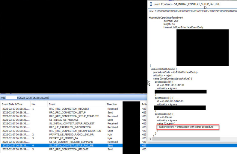

HandoverPreparationFailure [RadioNetwork-cause=interaction-with-other-procedure]
Hi All,
Can any one tell me the reason HOprep failure?
Nokia MME and Huawe eNB.

What is this private UE period message?
It’s just giving the TA value.

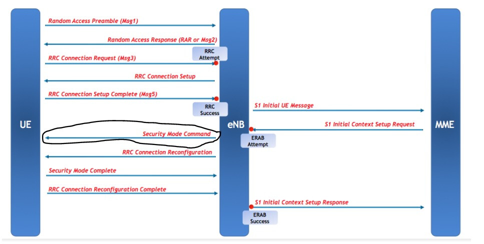

It’s observed there is no security Mode Command sent. You can investigate it.
