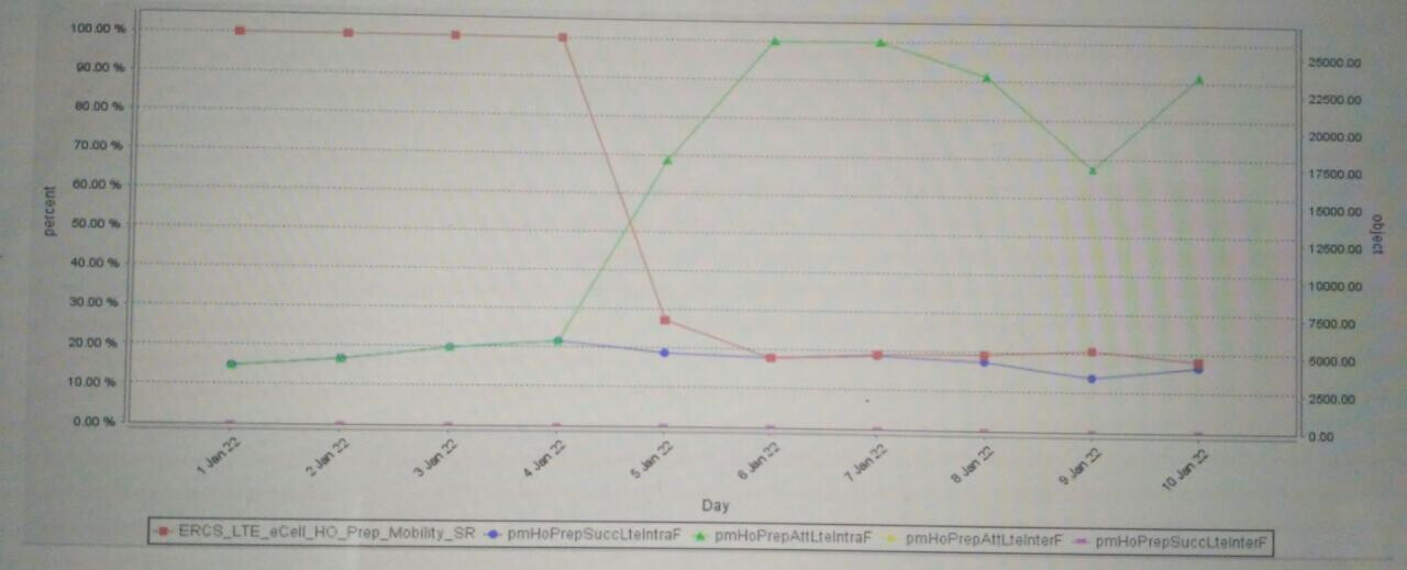

Handover Preparation Failures Solution
What are suggestions to solve Handover Preparation problem?

Hi @b50ft, check neighbour definition of Intrafreq with your neighbouring eNodeB.
Also check MME.
IP is correct or not.
Yes, this might be reason of Failure but also Wrong target eNodeB Id also be the factors as well.
Some common preparation failure reasons may be:
  1. Target cell Acquisition failure or SIB read failure
  2. Incorrect target cell id.
  3. T304 timer expiry
  4. RACH parameter setting issue
  5. UL Coverage Issue
Now, further analysis depends upon logs.

How could we say if its wrong target…? Far away cell…? Not adjacent cell…?
