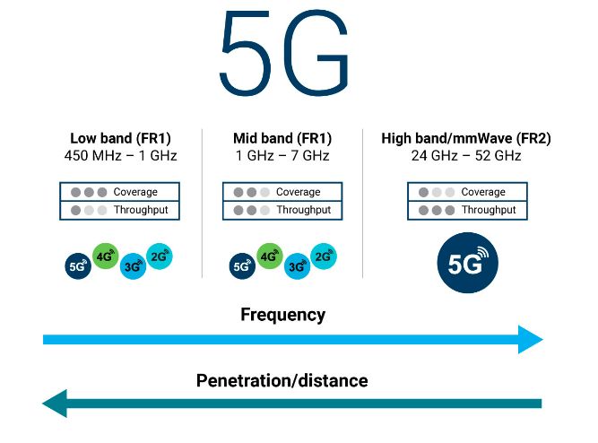

There are two frequency Ranges FR1, FR2, the two ranges are differing in BW and subcarrier spacing.
  • FR1: 410 MHz –7.125 GHz
    • BW: 5~100 MHz
  • FR2: 24.25 GHz –52.6 GHz
    • BW:50~400 MHz
5G can be classified to 3 layers as shown in the below image.
  1. Coverage Layer: Sub 1GHz
  2. Capacity Layer: 1 GHz ~ 7.125 GHz
  3. High Throughput: 24.25 GHz~ 52.6 GHz
