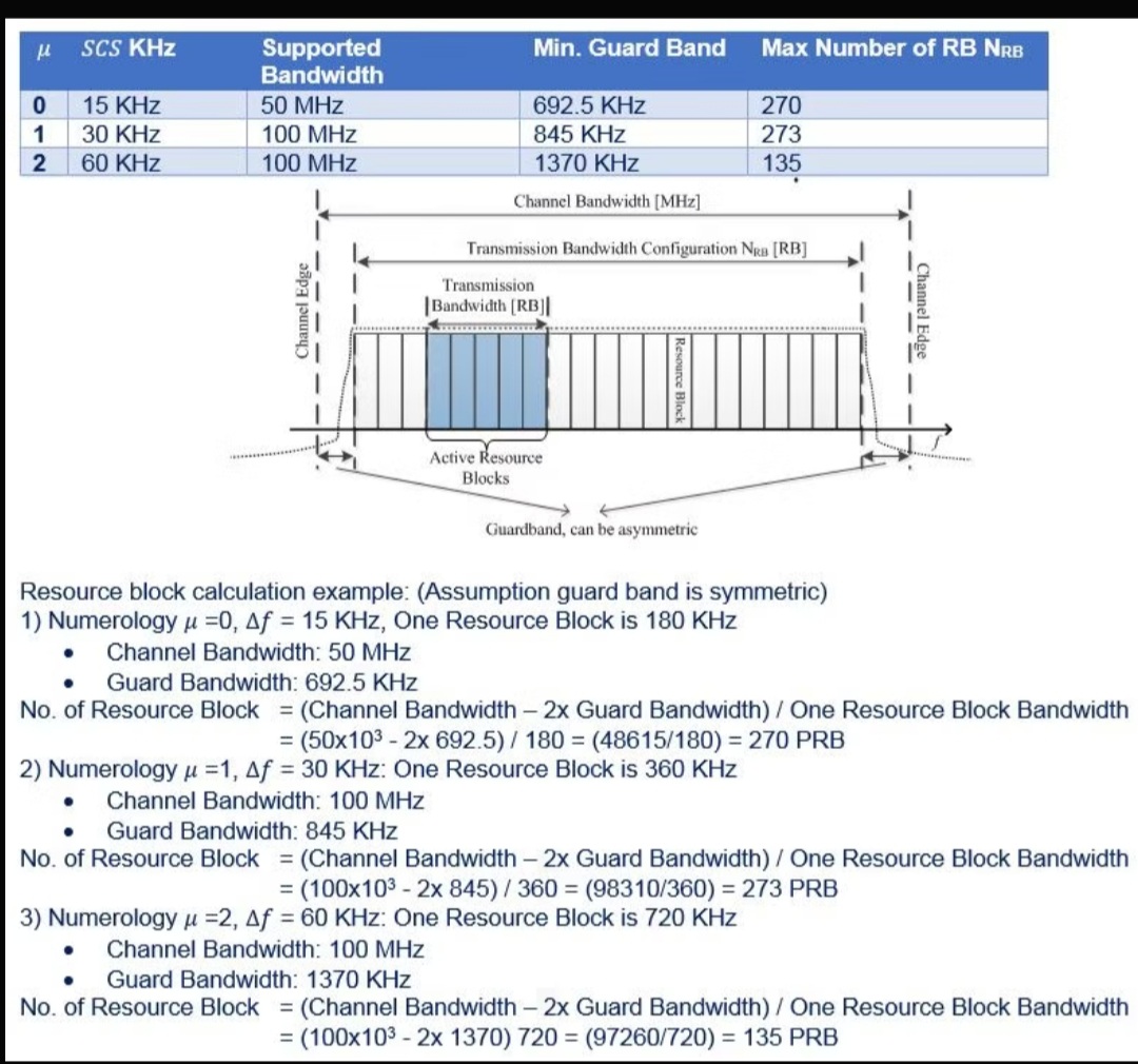

I think this will help
This is gaurd band calculation.for 5G NR gaurdband is relatively low in 5G as compared to LTE.

I think LTE and NR performance difference is because LTE’s PUCCH is transmitted in the band-edge, while NR’s PUCCH and PUSCH are flexible allocated within the band.
If MNO with NR can limit its RB allocation on the center of the band (according the the diagram), the enough guard band is there for LTE to maintain the performance.
