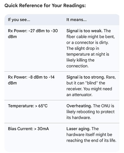

What to do if the numbers look “Perfect” (-19 to -23 dBm):
​If the signal is healthy, the issue isn’t the physical glass line. It’s likely software or power:
​The “Dying Gasp” Test: Go to System Tools > System Log. If you see “Dying Gasp” at 4 AM, it means the ONU lost power suddenly (bad adapter or wall socket).
​Firmware Updates: If it happens at the exact same time every night (e.g., 3:00 AM sharp), your ISP is likely pushing a configuration refresh that your specific unit is struggling to ha
ndshaking with.
