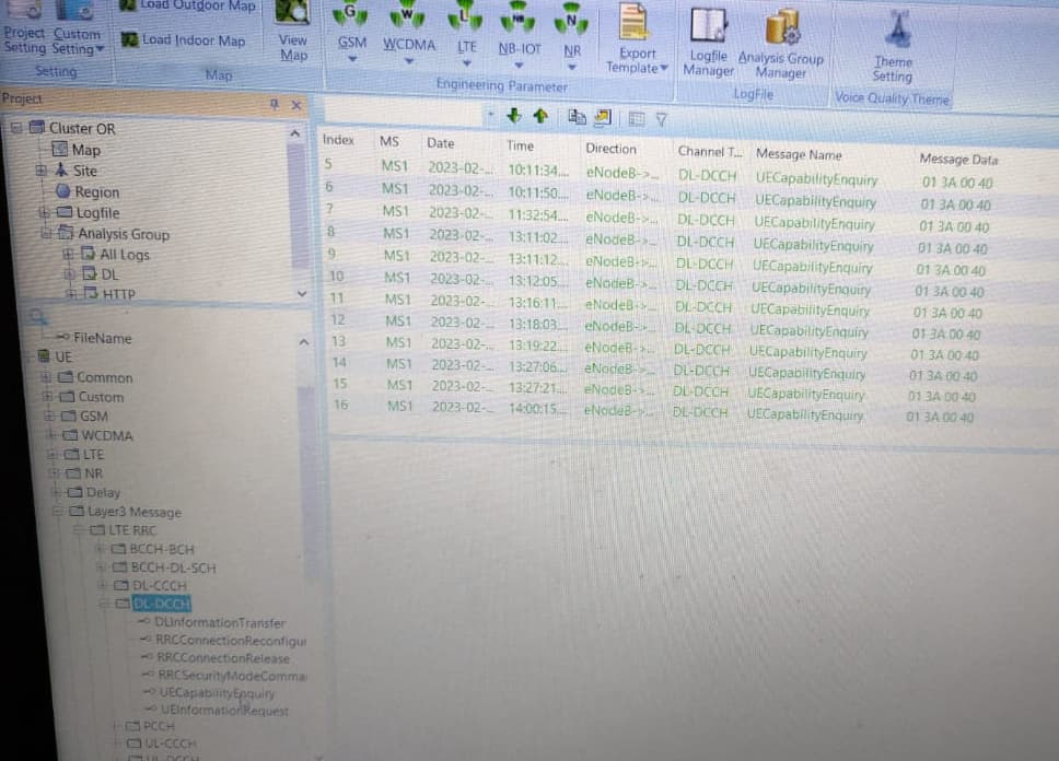

Please, any one have idea about where I can find frequency combination details in genex assistant?
Do you mean the eARFCN of PCC and SCCs?
Yes, exactly.
In UE capability info message in L3.
All supported CA combinations will be there.

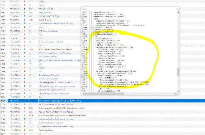

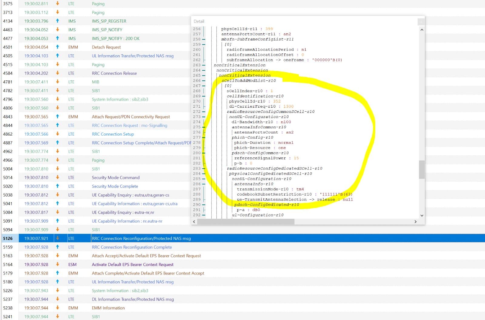

Make an export with all RRC reconfig where it says scell addition or removal and timestamps and work it out from there.
Like this:
