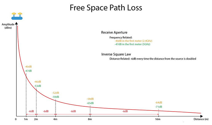

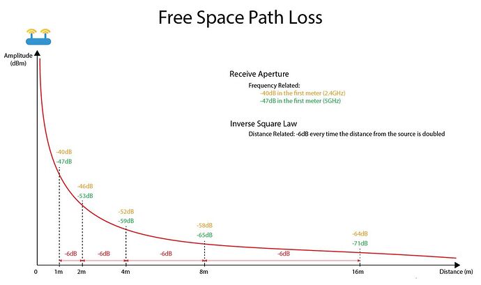

This image below shows how Free Space Path Loss (FSPL) increases with distance, following the inverse-square law. The curve demonstrates that every time the distance doubles, the signal power drops by about 6 dB which quickly weakens connectivity. It also highlights that higher frequencies like 5 GHz start with more loss in the first meter compared to 2.4 GHz, explaining why higher-band signals fade faster over distance.
