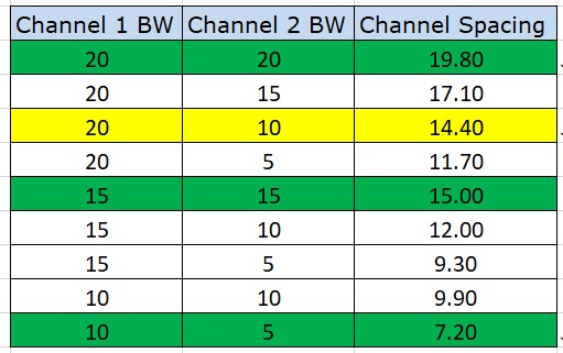

Here is table i prepare for different bandwidth combinations.

Channel spacing mean difference in center frequencies of 2 carrier.
Below is example (19.8 MHz):
