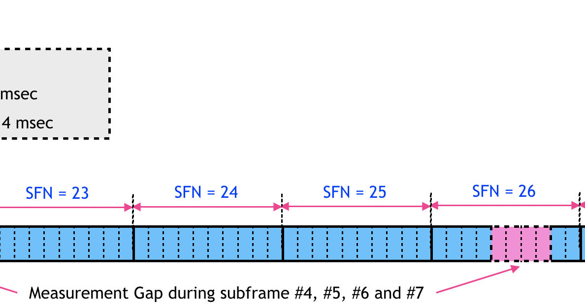

What this per FR measurements gap indicates?
3GPP has defined 2 types of measurement gap in NR:
See details here
How UE will measure another frequency range without a gap?
How it can measure 2 frequencies in the same time?
