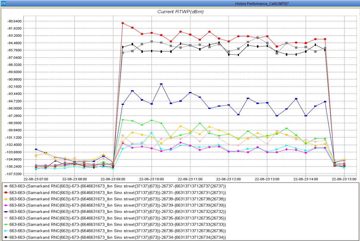

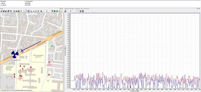

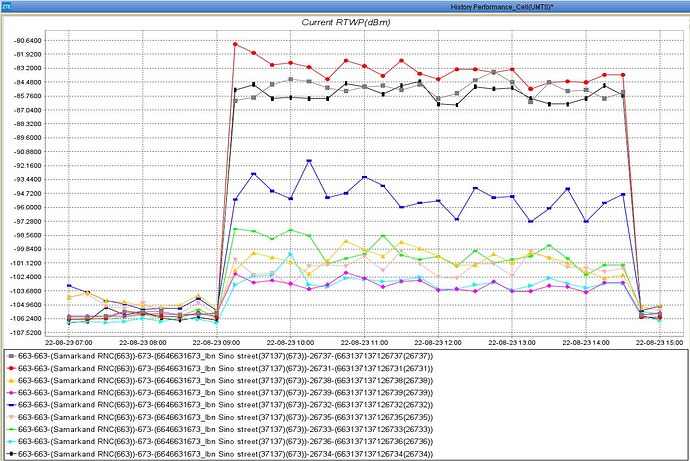

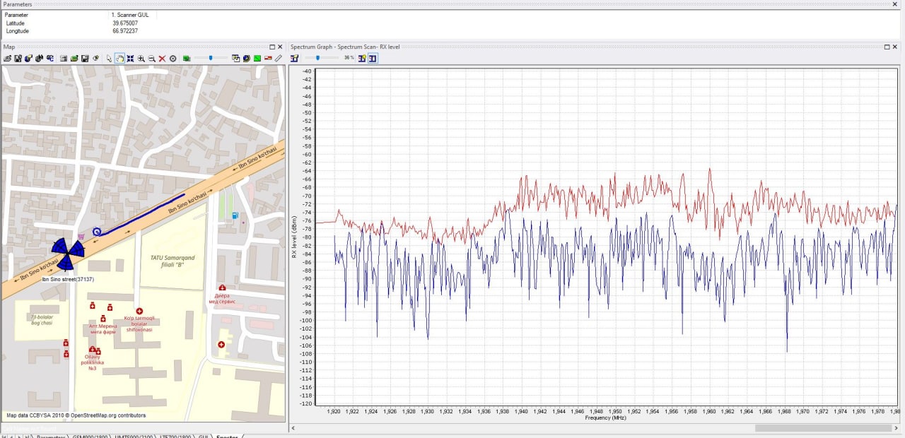

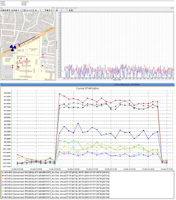

I sometimes use NEMO Outdoor to locate external interference, like repeaters, other operators’ faulty RRUs, etc. Before it I check KPI (high RTWP, Average NI of carrier, etc), and approximately map the location. Also I search for repeaters visually ![]()

Thank you. I’ve already conducted source hunting, as the interference is external. In our region, many users use repeaters to improve coverage in basements or congested areas, which is a major source of interference. To address this, we perform spectrum scanning and source hunting.
Recently, we’ve tested downtilting the cell slightly, which sometimes helps reduce interference by limiting coverage. However, this can lead to neighboring cells experiencing interference as their footprint expands and begins to pick up the source. Features can improve OSS KPIs, but the interference itself often remains.

What level of impact did you observe on the spectrum analyzer?
Is it limited to just a few RBs that you could blank without affecting the PDSCH and PUSCH?
