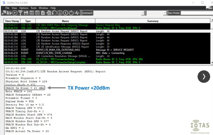

In weak uplink conditions, the UE does exactly what the standards tell it to do. It retries Msg1 with increasing PRACH transmit power until the eNB finally hears it.
In this real cell-edge capture, you can see:
:small_blue_diamond: Msg1 @ 20 dBm β†’ no response
:small_blue_diamond: Msg1 @ 24 dBm β†’ still no response
:small_blue_diamond: Msg1 @ 28 dBm β†’ marginal
:small_blue_diamond: Msg1 @ 32 dBm β†’ finally detected.
β†’ then Msg2, Msg3, Msg4 complete the access.
This is a classic reminder that uplink is usually the limiting link, not downlink.
You can have β€œgood signal bars” and still fail to attach if UL is constrained.
Key takeaways:
:backhand_index_pointing_right: Repeated Msg1 = uplink coverage problem, not core or NAS
:backhand_index_pointing_right: Rising TX power tells you the UE is hitting its UL budget
:backhand_index_pointing_right: Cell-edge issues are often PRACH-limited, not RSRP-limited
:backhand_index_pointing_right: This behaviour is expected and standard-compliant.
No theory. Just real RACH behaviour under stress.
