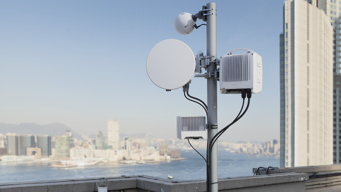

We use EBand then one can upto 10GBPS as well.
@SalemRF , please check this:

Eband could be 1 km hop.
Majorly small cells mesh or fiber going to be sort after.
cbd still fiber can be planned.
So maybe eband can help with 5G mmWave deployment as it requires high number of small cells.
But in the case of macro sites where distances are higher it’s not a practical solution?
