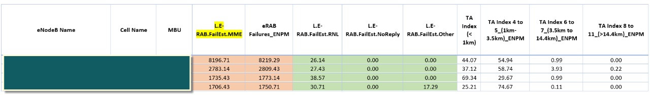

Few worst cells having almost 100% contribution of Number of E-RAB setup failures triggered by the MME

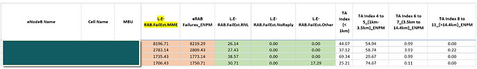

These are the top 4 worst cells having almost 100% contribution of Number of E-RAB setup failures triggered by the MME.
TA samples % sharing is shown,
Can any one tell how to improve from radio end or what to do basic checks?
