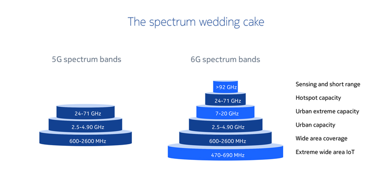

The 6G era’s enormous capacity demands will require new spectrum and extreme massive MIMO
Source:
What is 6G extreme massive MIMO?
Is it same concept like 5G massive MIMO?
I’ve seen such idea shown in IMC event ongoing.
