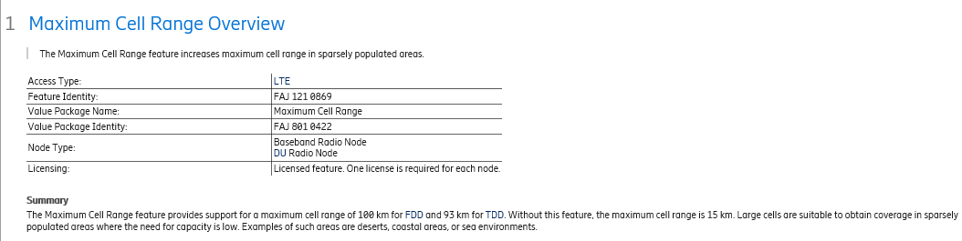

In Huawei system, there is a feature named “Extended Cell Range”.
In Ericsson as i know there is feature called MaximumCellRange for over 100Km but im looking for 50 to 60 km only.

The Maximum Cell Range feature provides support for a maximum cell range of 100 km.
Beyond 100 km is additional feature anyway beyond 100km requires maximum cell range feature to be operable.
Yes it has license…

From a 2020 documentation, I guess it’s a must if you want to reach greater than 15 Km. But to be honest not sure, better raise an inquiry with E… because it may depend on the bts model and sw version.
Yeah I understood it basing on your earlier comments that’s why I said that you need to activate Maximum Cell range not beyond 100 km. These are two separate features(separate but related). Without It you won’t be able to change cellRange attribute to >15km
