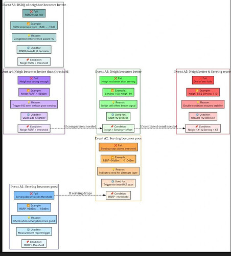

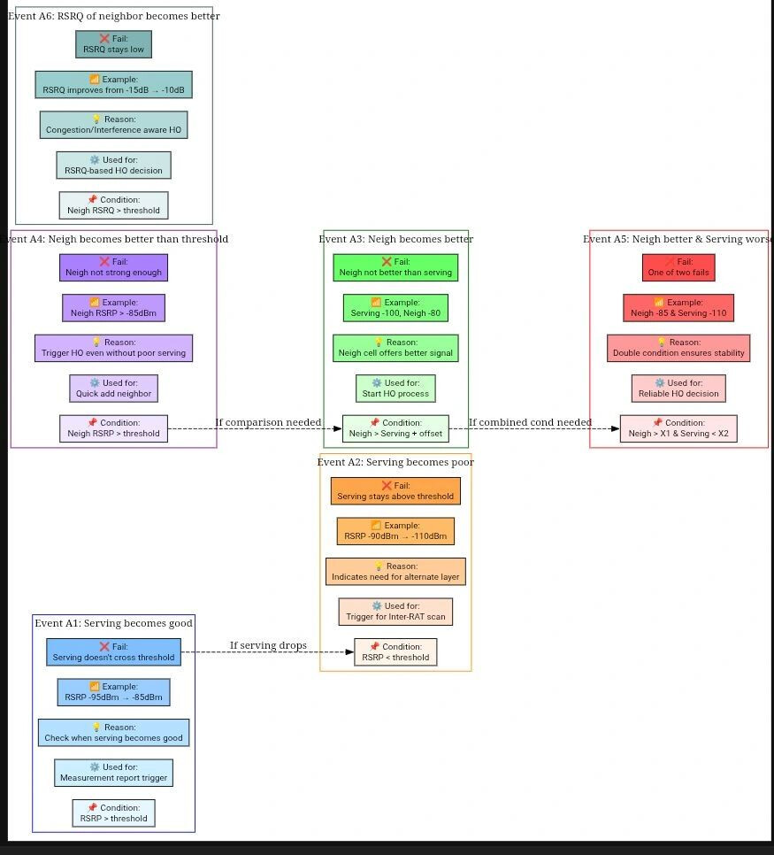

Event A1 to A6 — Explained Like a Workflowr
:dart: Note: These are mostly used for Intra-frequency and Inter-frequecy HO Event
:white_check_mark: Event A1: “Serving Cell Becomes Good”
  1. Condition:
    Triggered when the quality of the serving cell improves above a predefined threshold.
  2. Event Used: A1
  3. Why This Event?
    Used to stop measurement reporting of neighboring cells, because the serving cell itself is good enough.
  4. Example:
    UE moved out briefly but returned to center of the cell – no handover needed.
  5. Fail Condition:
    If wrongly configured threshold, UE may stay stuck in poor coverage.
  6. Handover Triggered? :x: No
    Just to suppress neighbor measurement.
:white_check_mark: Event A2: “Serving Cell Becomes Worse”
  1. Condition:
    Serving cell’s RSRP or RSRQ drops below threshold.
  2. Event Used: A2
  3. Why This Event?
To initiate neighbor cell measurements – preparing for handover.
  1. Example:
    UE enters the building basement – the serving cell becomes weak.
  2. Fail Condition:
    Delay in triggering A2 can cause RLF (Radio Link Failure).
  3. Handover Triggered? :x: No
    Only measurement is triggered, not actual HO.
:white_check_mark: Event A3: “Neighbor Better Than Serving by Offset”
  1. Condition:
    Any neighbor becomes better than the serving by a configured offset (e.g., 3 dB).
  2. Event Used: A3
  3. Why This Event?
    Main trigger for Intra-frequency handovers.
  4. Example:
    UE moving towards cell edge – neighbor becomes stronger.
  5. Fail Condition:
    Ping-pong handover if offset/hysteresis is poorly tuned.
  6. Handover Triggered? :white_check_mark: Yes
    Most common handover trigger in LTE.
:white_check_mark: Event A4: “Neighbor Cell Quality Better Than Threshold”
  1. Condition:
    Any neighbor becomes better than a fixed RSRP/RSRQ threshold.
  2. Event Used: A4
  3. Why This Event?
    Used for Inter-frequency HO – before comparing with serving.
  4. Example:
    UE moves into area with better second-carrier coverage.
  5. Fail Condition:
    If offset is too high, UE may miss opportunity to move.
  6. Handover Triggered? :repeat: Maybe
    Depends on how good neighbor is and serving condition.
:white_check_mark: Event A5: “Serving Becomes Bad AND Neighbor Becomes Good”
  1. Condition:
    Dual condition:
    → Serving < Threshold1
    → Neighbor > Threshold2
  2. Event Used: A5
  3. Why This Event?
    Used for Inter-frequency handovers or cell reselection where cross-check needed.
  4. Example:
    UE moving into weak zone of current frequency but another carrier is stronger.
  5. Fail Condition:
    If only one of the two conditions satisfied, HO not triggered.
    Once both thresholds are crossed.
:white_check_mark: Event A6: “Neighbor Secondary Cell Better than Threshold”
  1. Condition:
    Secondary cell RSRP/RSRQ goes above threshold.
  2. Event Used: A6
  3. Why This Event?
    For Carrier Aggregation (CA) — adding/removing Secondary Cells (SCell).
  4. Example:
    UE enters a zone where SCell is usable for higher data rate.
  5. Fail Condition:
    If SCell becomes weak again, addition fails.
    Not a handover — SCell addition/removal only.
