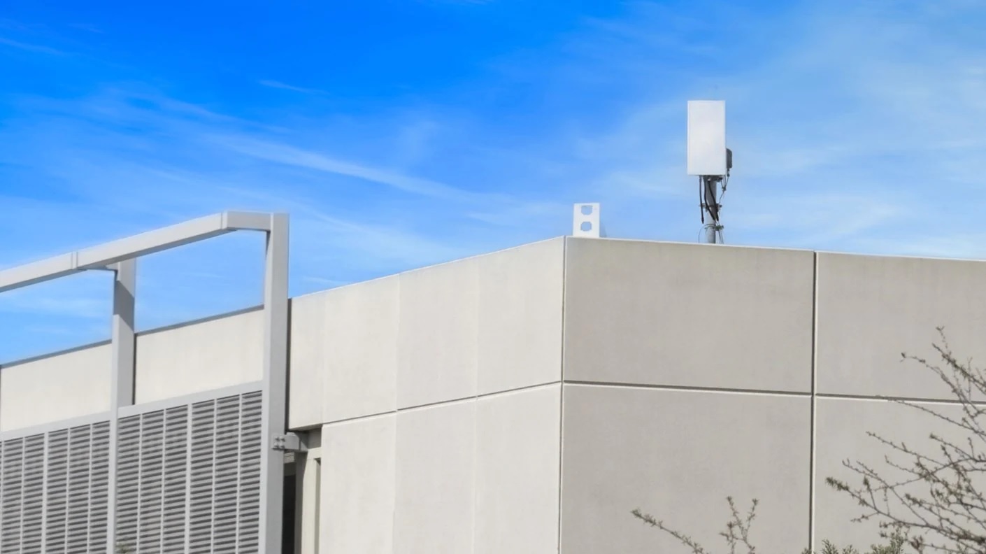

Ericsson pushes 5G uplink limits with MIMO
Ericsson hit what it claimed was a single-user uplink record using multiple input multiple output (MIMO) technology, taking a step toward overcoming what one executive identified as a key limitation on mobile connectivity.

The vendor ran the trial on its commercial C-Band radio system, combining single-user MIMO with 256-QAM and its Uplink Booster technology in standalone 5G mode. Using a 100 MHz channel of spectrum from 3.7 GHz to 3.8 GHz, it reached a peak data rate of 315 Mbps on a mobile test device equipped with Qualcomm’s Snapdragon X60 5G platform.
